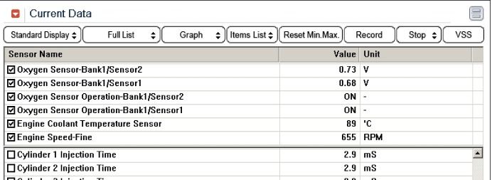

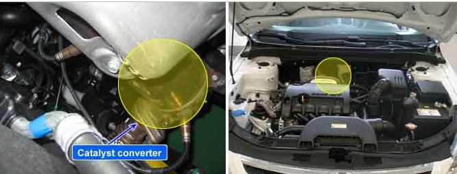

The catalyst’s efficiency is demonstrated by its ability to oxidize CO and hydrocarbon emissions. The Powertrain Control Module (ECM) compares the output signals of the front and rear oxygen sensors to determine whether the output of the rear sensor is beginning to match the output of the front oxygen sensor. Air/fuel mixture compensation keeps the frequency of the front oxygen sensor high due to the changes from rich-to-lean combusition. The catalyst causes the rear oxygen sensor to have a lower frequency. As the catalyst wears, the rear oxygen sensor’s signal trace begins to match the front oxygen sensor’s signal trace. That is because the catalyst becomes saturated with oxygen and cannot use the oxygen to convert hydrocarbon and CO into H₂O and CO₂ with the same efficiency as when it was new. A completely worn catalyst shows a 100% match between the frequency of the front and rear sensors.
If you release the accelerator pedal suddenly after engine running about 4000 rpm, fuel supply will stop for short period and the O2 sensor service data in the GDS (Pro) will display values 200mV or lower. When you suddenly press on the accelerator pedal down, the voltage will reach 0.6 ~ 1.0 V. When you let the engine idle again, the voltage will fluctuate between 200 mV or lower and 0.6 ~ 1.0 V. In this case, the O2sensor can be determined as good.
Trích nguyên văn diễn giải lỗi P0420​
